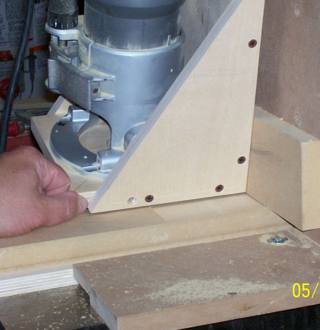

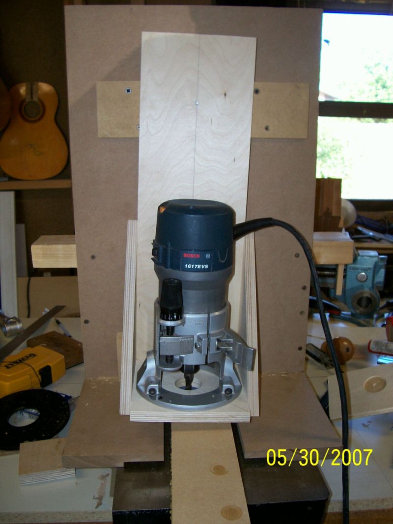

I decided to use the MDF.  Like you say Rod, it'll be 1 1/2" thick so it should be stiff enough.  Does anyone have any pics or ideas for a router pendulum?  Specifically I am wondering about supporting the router weight and keeping everything stiff.  Also wondering about using a 4 penny nail or 1/4" pin for the pivot.  I want to run the whole thing vertical instead of horizontal like I've seen others do. Any ideas for me?  Thanks.

I came up with something.  Havn't tried it but I'm sure it will work well enough.  You can see the MDF gettin' ready to be cut.  Used a 3/16" pin for the pivot.  I'll let y'all know how it worked tomorrow.

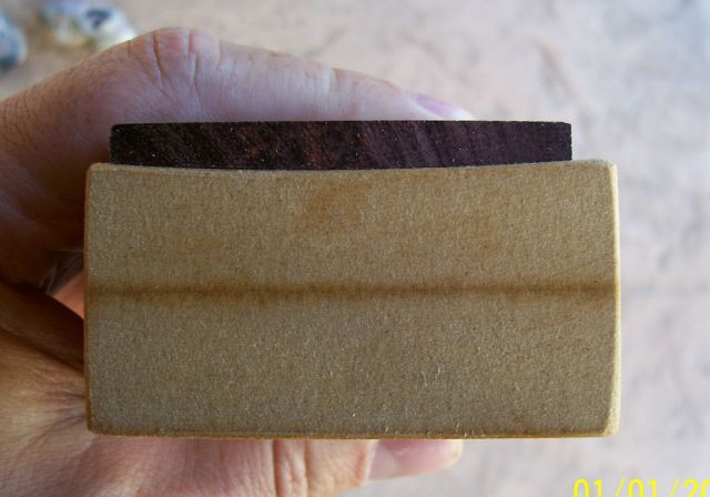

Well, everything went awesome.  This all started because I made the Marty McClary and Todd Stock fretboard radius jig and needed a clamping caul.  The jig worked well by hogging off material then skimming the final pass.

The fretboard was radiused using the McClary jig.  Thanks for your help with that Todd.  Nice fit.
